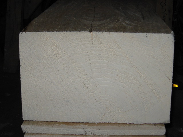

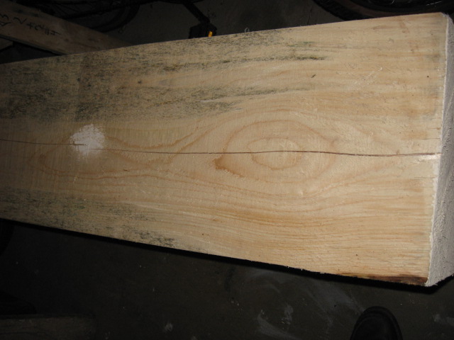

Here are some pictures I just took.
As you can see, there is a crack running in the middle of the beam. I am planning to split it in this crack, then start resawing from there.
To get the most tops, I plan to resaw some at 90 degree then to keep my resawing radial take some wedge (for mando or violin, etc) then some more continue with more guitasr tops.
What do you think.
My fellow should have left it thicker

Oops forgot the pictures...
